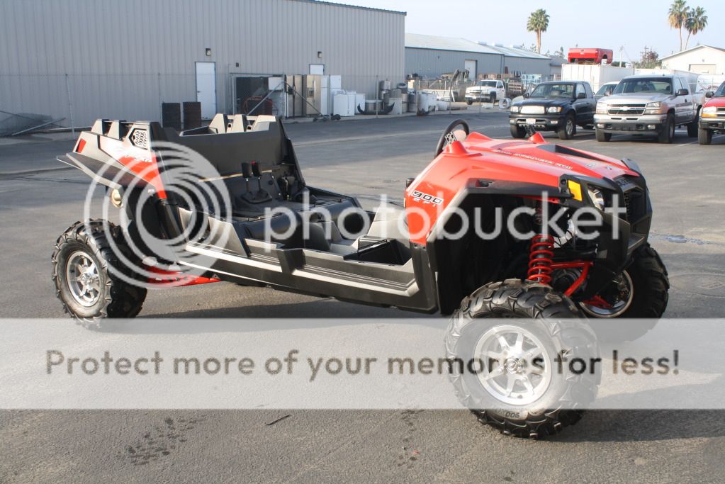

A utvunderground.com member from North Carolina had been following our Cognito Best In The Desert build and then our racing this season, shown below. This member really liked the look of our car as well as could see we are very competitive with it. We are fortunate enough to now call this forum member a customer, as his brand new 2012 Polaris RZR XP 4 900 was just shipped out here to California to begin a build that will compete in the 2013 season of UTV Rally Raid! http://utvrallyraid.com/
Stay Tuned!!

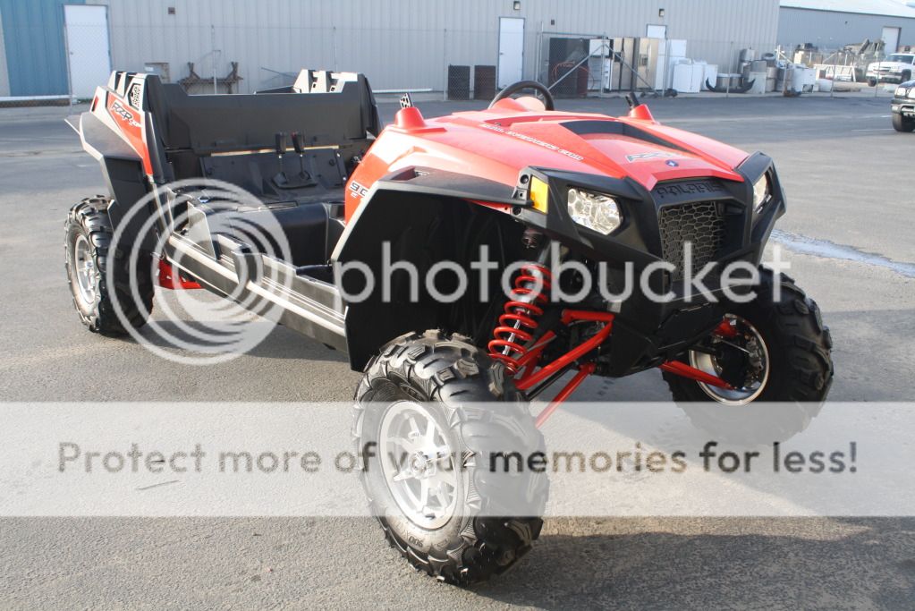

Stock seats are coming out, new Corbeau baja xp seats will take their place, but will be lowered and moved back, the nice thing about building a 2 seater from the long wheel base 4 seater is we have room to move the seats back. Therefore all stock seat mounting is being removed along with all the extra steel and plastic that is un needed for this build. no stock seat belts either, we will use DJ Safety 3"x3" 5 point harnesses. At this point all the un wanted is gone, new seats are positioned and mounted, which means we are just about ready to begin building the chassis. Progress pics below!
